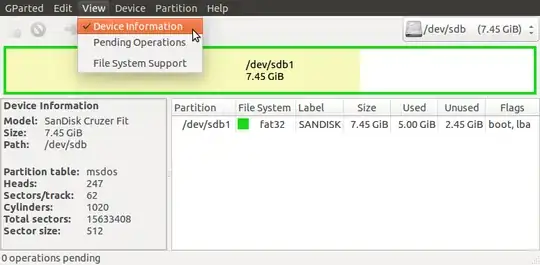

  1. GUI-method - Using GParted
    To find out what partition table type the selected drive has select View > Device Information from the menu.
    GParted showing /dev/sdb selected and 'Device Information' menu entry

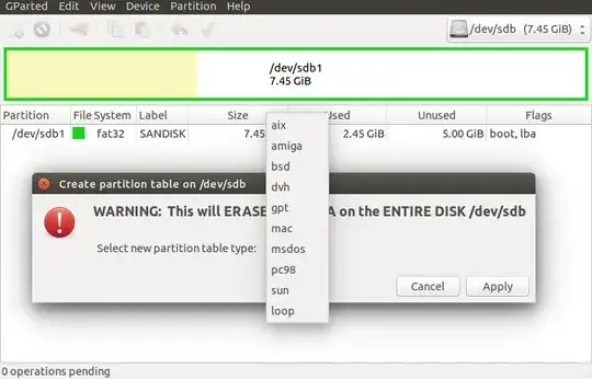

    Select the disk of which you want to change the partition, then select Device > Create Partition Table from the menu.
    GParted showing 'Create Partition Table' menu entry
    If you get a warning that the device contains active partitions, unmount these. Note that you cannot unmount partitions of your currently running operating system. You will then see the window below, where you can choose the partition table type. msdos is what GParted calls the old format, gpt the newer one. All the others for other operating systems or architectures.
    Please also note the warning message. Creating a new partition table will discard all information about existing partitions on the disk. It will not overwrite data on the partitions, but you still don't want to have to dig through and restore data afterwards. Therefore consider the old partitions gone and all data lost after you created the new partition table and backup your data before doing so.
    GParted asking to create a partition table on /dev/sdb
