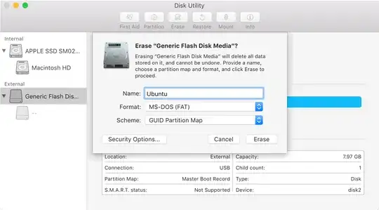

  2. To ensure maximum compatibility with Apple hardware, first blank and reformat the USB stick using Apple's "Disk Utility", but this step can be skipped if you intend to use the USB stick with only generic PC hardware.
    • Launch Disk Utility from Applications -> Utilities or Spotlight search.
    • Insert your USB stick and observe the new device added to Disk Utility.
    • Select the USB stick device (you may need to enable the option View -> Show All Devices) and select Erase from the toolbar (or right-click menu).
    • Set the format to MS-DOS (FAT) and the scheme to GUID Partition Map.
    • Check you've chosen the correct device and click Erase.
    Warning: Disk Utility needs to be used with caution as selecting the wrong device or partition can result in data loss.

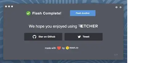

  3. Install and run balenaEtcher
    To write the ISO file to the USB stick, use a free and open source application called balenaEtcher. After downloading this and clicking to mount the package, balenaEtcher can either be run in place or dragged into your Applications folder.

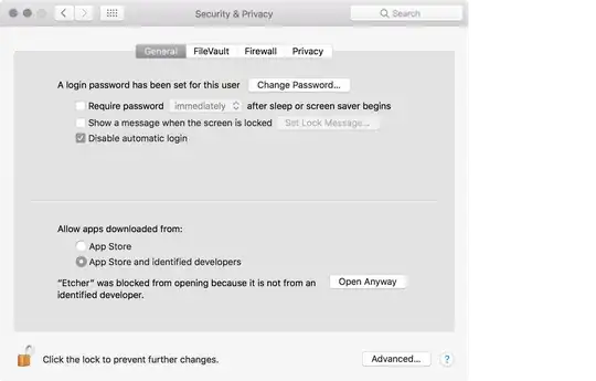

    By default, recent versions of macOS block the running of applications from unidentified developers. To side-step this issue, enable App Store and identified developers in the Security & Privacy pane of System Preferences. If you are still warned against running the application, click Open Anyway in the same pane.

  5. Write to device
    After entering your password, balenaEtcher will start writing the ISO file to your USB device.
    The Flash stage of the process will show progress, writing speed and an estimated duration until completion. This will be followed by a validation stage that will ensure the contents of the USB device are identical to the source image.
    When everything has finished, balenaEtcher will declare the process a success.
    Congratulations! You now have Ubuntu on a USB stick, bootable and ready to go.

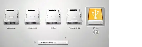

  6. Boot your Mac
    If you want to use your USB stick with an Apple Mac, you will need to restart or power-on the Mac with the USB stick inserted while the Option/alt key is pressed.
    This will launch Apple's 'Startup Manager' which shows bootable devices connected to the machine. Your USB stick should appear as gold/yellow and labelled 'EFI Boot'. Selecting this will lead you to the standard Ubuntu boot menu.
