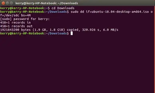

Terminal Screen print
cd Downloads
sudo dd if=input.iso of=/dev/sdc bs=4M
Tip - on my system it is Downloads not downloads - uppercase D - check.
Tip - To be sure I get long filenames correct (such as the ISO download) I right click to rename the file and copy the file name so I can paste it into terminal later (ctl/shift v).
Tip - after you enter the password for sudo in terminal mode it may seem frozen for several minutes - just be patient.
Tip - check your dd syntax to avoid data loss
I have just done all this to test it for you, download took 15 mins, dd command about 5 mins (not exactly sure as I went and made a cup of tea!)
Do not forget you may need some bios changes so youy can boot from the USB stick - even if this still does not help you - I now have a Ubuntu 18.04 LiveCD USB boot stick that works! So time for some fun exploring!
