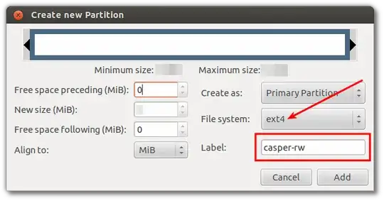

  1. Your target USB disk must have at least two partitions; I recommend using GParted to create a new partition table.
    • The first partition must be vfat/FAT32, and minimum size 750 MB (or more if you are using a live DVD image).
    • The second partition should be ext4, sized to whatever you want your persistent storage to be (no limits), but it must be labeled casper-rw (all lower case, no quotes)
    Enter image description here
    • You can, of course, add third, fourth, extended/logical partitions, etc. if you would like to.

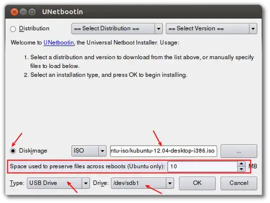

  2. Use UNetbootin to write your chosen live CD ISO to the first (vfat) USB partition.
    • Put a tiny size for UNetbootin's persistence option (say, 10 MB) to make life easier; don't worry, we won't actually be using this casper-rw file.
