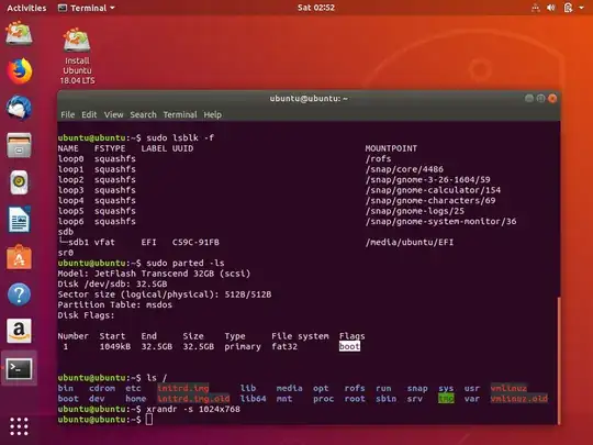

My experience was from earlier versions, so I tested now with Ubuntu 18.04 LTS.
The first attempt was a little tricky and flaky. I had to remove 'quiet splash' from the grub menuentry in order to make it boot all the way in my Toshiba laptop (which is my test computer). I tried again and found that the electrical connnection was flaky with the pendrive I used. The connection went on and off, when I wiggled a little on the pendrive.
So I tested with another [less worn] combination of pendrive and USB hub, and now it works flawlessly. The following screenshot shows that it works even when those links are broken (red in the list by ls). Please notice the boot flag. I think it is important.
