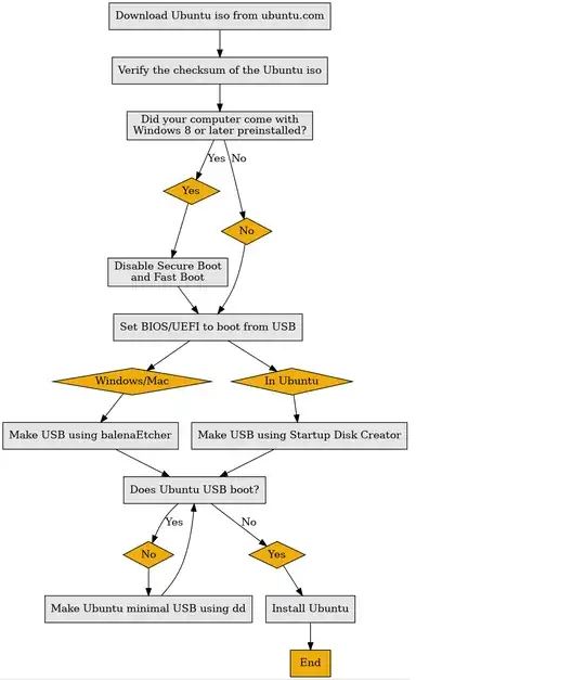

This flowchart shows how to make a bootable Ubuntu installation USB in Windows/Mac/Linux, and how to troubleshoot problems booting Ubuntu from it. In this flowchart I use balenaEtcher, as it runs on Windows, macOS and Linux. Choose the version that corresponds to your current operating system, download and install the tool.

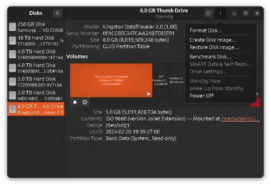

How to use Disks utility (gnome-disks) If you have a bootable iso;
  • Insert the USB.
  • start Disks utility.
  • Mark the USB.
  • Click the vertical ellipsis button ( ).
  • Choose Restore Disk Image.
  • Select the image to restore and make sure the Destination is your USB.
