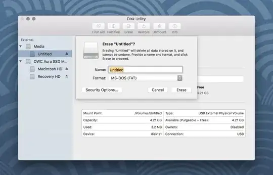

  3. Open Disk Utility from Applications > Utilities
  4. Select the USB stick and select Erase (This will remove all data stored on the USB drive)
  5. Select the format: MS-DOS (FAT) and scheme: GUID Partition Map
  6. Click Erase
    Disk utility

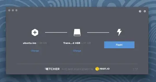

  7. Download, install and open Etcher (By default MacOS blocks running apps from unidentified developers. Follow this tutorial if you are experiencing problems with this.)
  8. Select image and navigate to the location you saved the Ubuntu ISO you have downloaded in step 2
  9. Select the USB drive you have formatted in step 3-6.
  10. Click Flash
    Etcher interface
  11. Congratulations! You now have Ubuntu on a USB stick, bootable and ready to go!

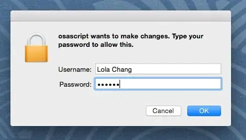

  4. Launch UNetbootin and allow the osascript to make changes
    authentication

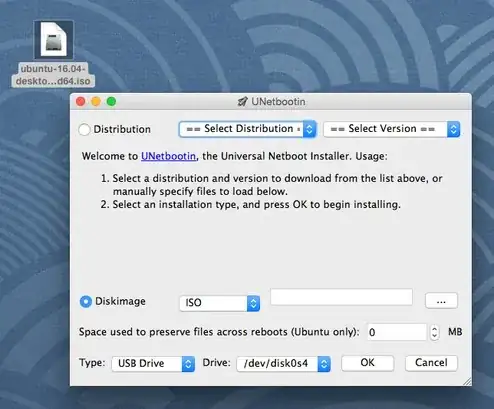

  5. Select the Diskimage radio button and then click the ... button
    unetbootin interface

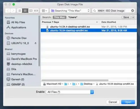

  6. Select the ubuntu ISO file you downloaded and click 'Open'
    selecting iso file
