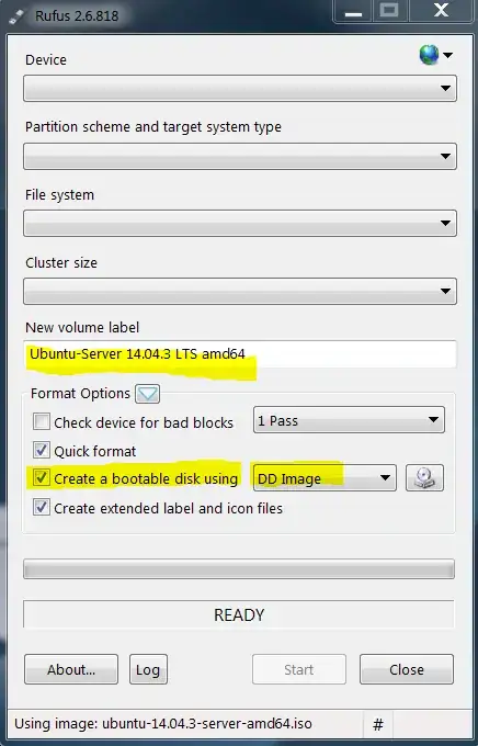

I usually use Rufus for USB images and when I create a bootable disk using ISO images for Ubuntu Server, it breaks at mounting CD/ROM device stage but when I change it to DD Image it works.
Rufus DD Image Option
