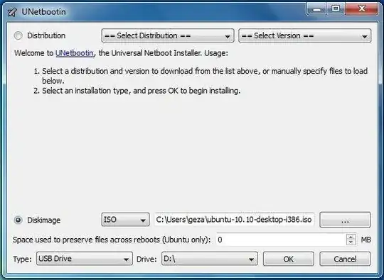

With UNetBootIN, for example. I like Pendrive Linux Easy USB Creator very much, but it doesn't support béta's without some tips 'n tricks. Testing an alpha isn't as simple as you think by the way, some experience is useful ;)
Download for Windows
Screenshot from unetbootin homepage
Unetbootin is available for Windows, Mac, Linux (Lots of distros)

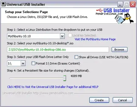

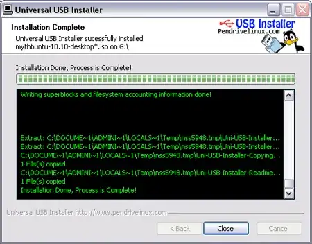

you can use universal usb installer go to http://www.softpedia.com/progDownload/Universal-USB-Installer-Download-186578.html
install it
and then run it and select your linux version
and pendrive which is to be make as statup disk

Open Unetbootin ...select daily_live ...that surely will boot.

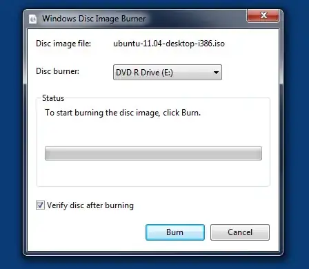

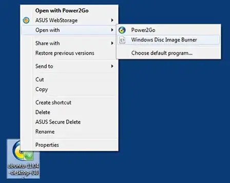

Ubuntu ISOs (since 11.10) are hybrid, they are both CD and USB bootable. On Linux, you can just cat them to a flash drive.
On windows, follow the instructions here: http://www.ubuntu.com/download/ubuntu/download
Windows 7
Right-click on an ISO image and choose 'Open with > Windows Disc Image Burner'.
Select a disk burner (drive) and choose 'Burn'. If you check 'Verify disc after burning', it will confirm that the ISO image has been burned correctly.

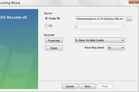

Windows Vista / XP / Server
Download and install the appropriate version of ISO Recorder. Insert an unformatted DVD into your burner. (Note: You can only burn DVDs with this tool from Vista.)
Open Windows Explorer, find your ISO file, right-click and choose 'Next'.
