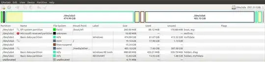

Also, when I first tried to install gparted, it gave me a message about low disk space. I ran autoclean and autoremove, and then I was able to install it. This is what gparted shows for my partitions.
gparted
First you need to run gparted from live cd/usb, cause it can't do anything with partition it running from, and all other mounted partitions.
How to make bootable usb, boot from it, choose "try without installing" in boot menu, then run gparted.
  • make sda8 smaller and move to the right(close to end of disk)
  • move sda7 to the right, placing it just before sda8
  • now you have unallocated space to the right of sda6, expand it to that space and you'll get a lot of free space in Ubuntu
Note, backup important files/documents you have in Ubuntu
You using sda8 to store something, make it's size enough to store your data but much less then 400Gb, this size difference will go to ubuntu partition
You should follow instructions carefully, incorrect usage of gparted can corrupt your installed OS
