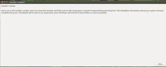

During fresh installation procedure I get this error:
Error installing /cdrom//pool/main/g/glibc/locales_2.19-18+deb8u2_all.deb
trying to overwrite '/usr/sbin/validlocale', which is also in package libc-bin 2.21-0ubuntu4
After closing this error, another one pops up saying the installer has crashed
installer crashed, report a bug
I booted my laptop from a live USB which has iso of Ubuntu 15.10.
I used unetbootin to make the bootable USB.

The problem is actually in unetbootin. If you start unetbootin from the same version as you are trying to install, there should be no problem. I tried installing 14.04.4-LTS or 15.10 with a stick made wit unetbootin from 12.04 LTS, and I had the same error. Since I did not have any system, I tried the Rufus-tool on Windows and that made perfect install stick....
