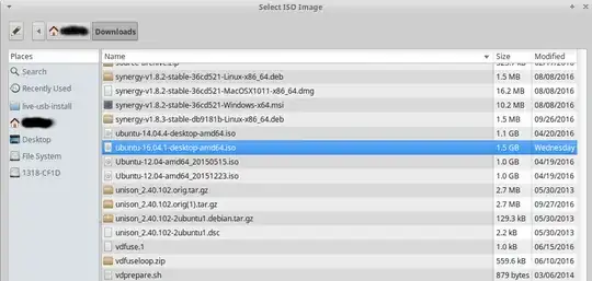

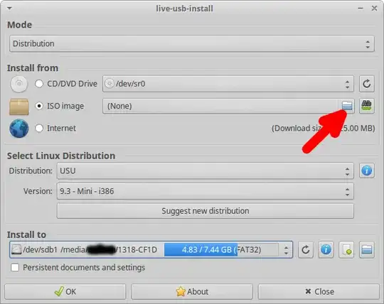

  4. After the program launches, select the ISO you are going to use:
Click Open to Select ISO file

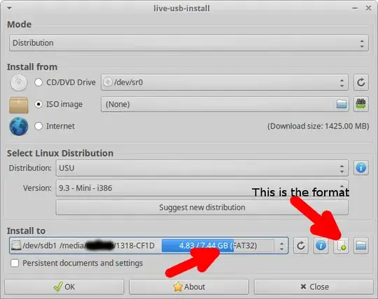

  1. Select the proper USB drive and the Format button to format your USB to FAT32 (syslinux won't install in anything other than NTFS or FAT32):

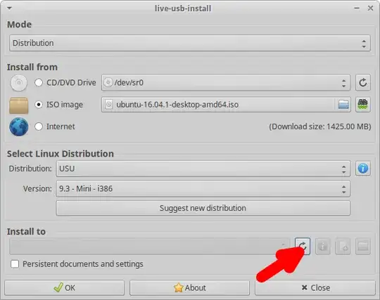

  1. After formatting, remove and reinsert the USB drive.
  2. Select Refresh so it sees your drive again.

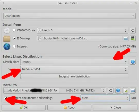

  1. Select Distribution, Version, Persistent and Size you want for storage (for now 4095 or 4GB is the maximum due to size limitation of FAT32):
  1. Click OK and be patient, this will take a while to create.

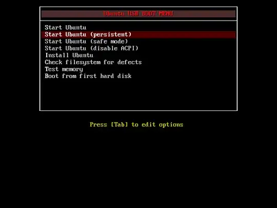

  2. Boot to USB and select the persistent option.
You should now be able to install applications into the LiveUSB and still be there on a reboot. Enjoy!

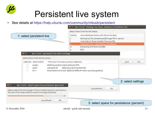

The following picture illustrates the dialogue to create a persistent live drive.
Select the source file, the Ubuntu ISO file you've downloaded beforehand.
Choose the target, which is the drive letter for your USB drive.
Be sure to back up your USB first, if you have any data on it, that you haven't backed up already. Mkusb will format, wipe or overwrite the drive completely.
In old versions of mkusb, if you see Live only selected, instead of Persistent live, double-click on the option line to get the latter option.
In the later stages of the process, you'll be prompted to tell Mkusb how much percentage of the storage you want to use for persistency. If you type in less than 100%, Mkusb will format the remaining space as an NTFS partition, named usbdata, for which you can store data. That partition will be visible and usable, in Linux and Windows, alike.

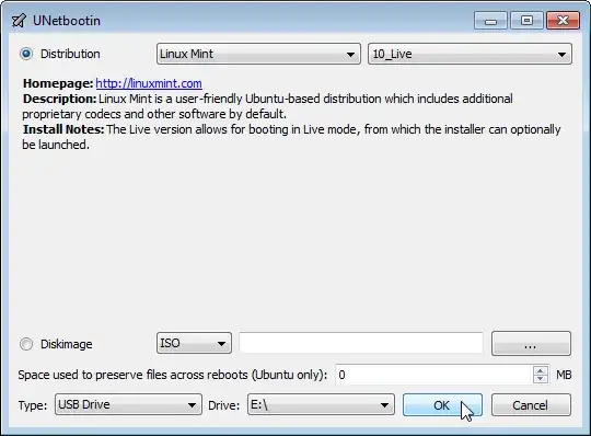

Look under UNetbootin:
unetbootin screenshot
In the bottom of the picture it says: "space used to preserve files across reboot (Ubuntu only)" you can see the number of Gb you want there.
