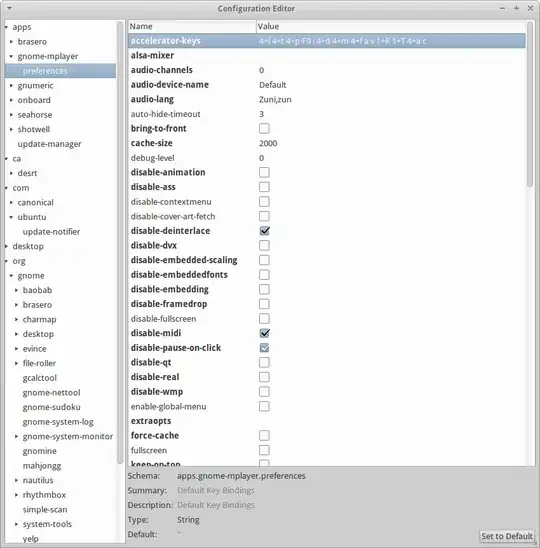

Using dconf-editor to change settings
The GUI program, dconf-editor is installed with dconf-tools package by clicking here or by running
sudo apt-get install dconf-tools
Then run it by entering in the terminal or in the quick launch menu, dconf-editor.
As you can see in the screenshot, all the various schemas can be expanded on the left hand side and the appropriate key selected. It is very straightforward to navigate to the value you want (in this case the gnome-mplayer preferences). You can click the check box to have a value activated or add a numerical value into one of the other boxes. You can also search within dconf editor with Ctrl+F keyboard shortcut.
You can also add another log say to log-viewer by adding a path in the form ['/var/log/auth.log', var....'] in the screenshot below.
