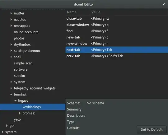

Use dconf Editor. If it's not installed by default you can get it with sudo apt-get install dconf-tools. The shortcut can be modified at Org > Gnome > Terminal > Legacy > Keybindings.
Screenshot of dconf Editor
This works for me in Ubuntu Gnome 16.04. Reference: https://bugzilla.gnome.org/show_bug.cgi?id=738325
