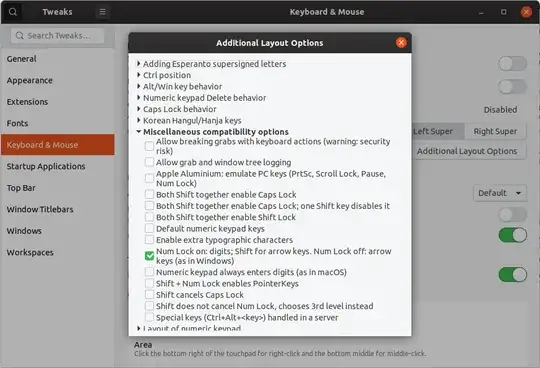

On Ubuntu 19.10, you can get this functionality by installing gnome-tweak-tool, then opening it, going to Keyboard & Mouse -> Additional Layout Options then expanding Miscellaneous compatibility options and checking Num Lock on: digits; Shift for arrow keys, Num Lock off: arrow keys (as in Windows), as shown here:
Gnome Tweak Tool Config
The changes take effect immediately. It seems to change the same setting as the answer by @AlainD

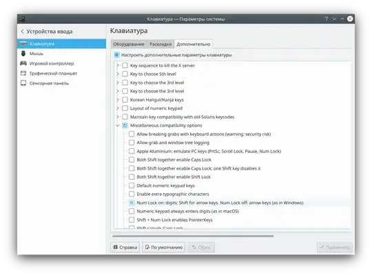

Kubuntu 20.04 also has Miscellaneous compatibility options menu! So, you can fix numlock and shift+home / shift+end issue.
