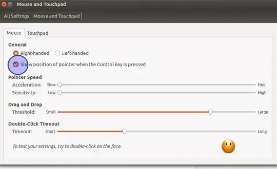

Its under 'Mouse and Touchpad' in System Settings

For those in Ubuntu 22.04:
The Locate Pointer option is listed in Settings->Accessibility. Turn it off.
