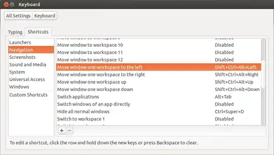

The System Settings menu has a Keyboards item that you can use to re-bind the shortcut:

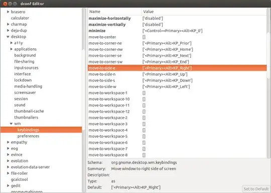

It might be worth checking the following dconf seettings:
  • move-to-side-e
  • move-to-side-w.
They can be found in the following path org.gnome.desktop.wm.keybindings.
