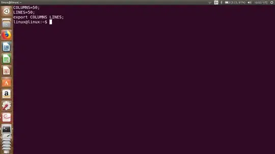

Inside the terminal when I type resize -s 50 50 terminal output is changed as rows 50 and columns 50.
But after closing the window and reopen terminal doesn't reflect the changes.
I want to open the terminal all time as rows 50 and columns 50.

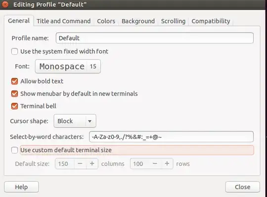

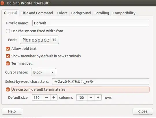

I know this can be done using terminal Edit->Profile Preference->General setting with changing the rows and columns number, but I want to do this in CLI, because I have to do this inside a big script.

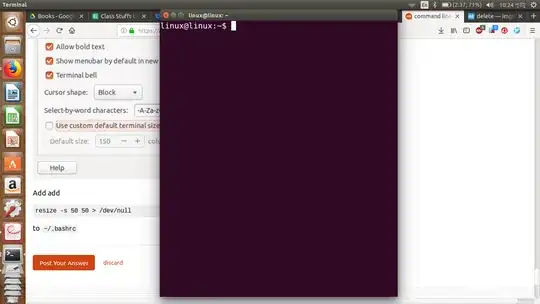

It works for me when I unselected use custom default terminal size
Add add
resize -s 50 50 > /dev/null
to ~/.bashrc
After pressing CtrlAltT
