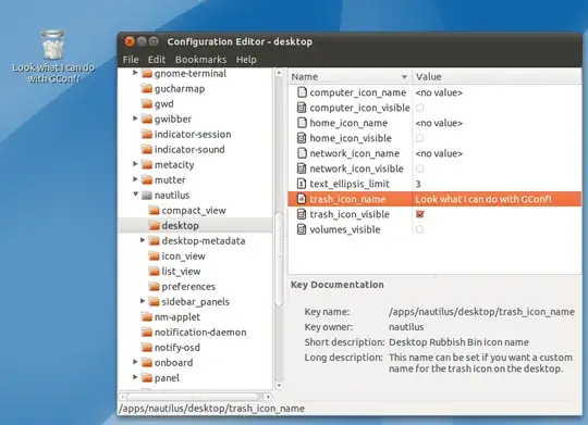

What was your question again? Oh, that's right: How do I use the Gconf editor?
gconf-editor is the graphical interface to manage Gconf settings. By default, it is not displayed in the menus. The easiest way to start it is by pressing Alt+F2 to bring up the "Run Dialog." Next, enter gconf-editor.
gconf-editor allows you to browse through the key-value pairs in a tree. Let's look at the example from above. Browse to apps > nautilus > desktop and you will see the trash_icon_visible key.
