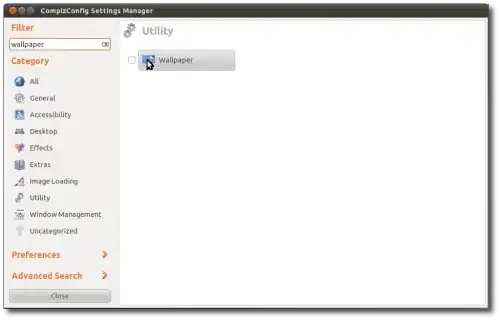

You can get the Wallpaper plugin for Compiz by installing compiz-fusion-plugins-extra (sudo apt-get install compiz-fusion-plugins-extra). It will show up under the Utility category in CompizConfig Settings Manager.

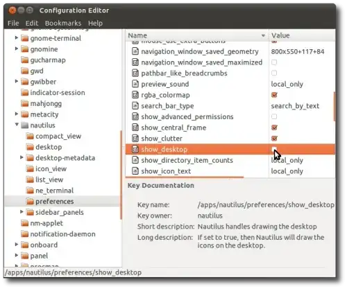

Before you can use it, you'll have to configure Nautilus to not draw the desktop. Run gconf-editor and uncheck the setting /apps/nautilus/preferences/show_desktop. This will make all of your desktop icons disappear, and there is no solution to this drawback at this time.

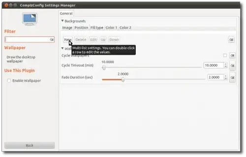

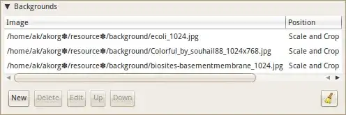

To configure the Wallpaper plugin, add images to the list of backgrounds. They will be assigned to workspaces in the order they are listed, and you don't have to have the exact right number:
CompizConfig

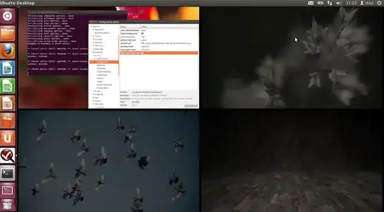

The result:
Expo

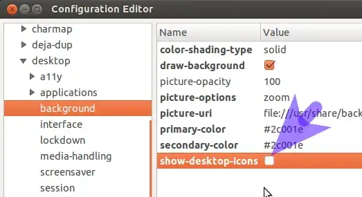

Now the very strange bit - by default the show-desktop-icons is unticked. Click it to tick it and click it again to untick it.

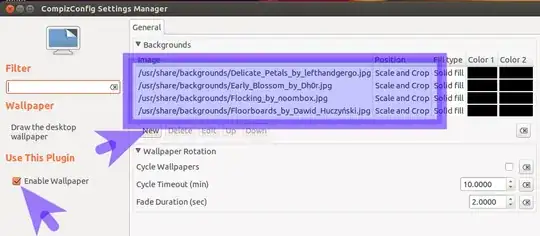

Launch the Dash and search for ccsm

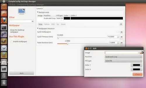

Filter to wallpaper - enable the wallpaper plugin and add New wallpaper as shown.

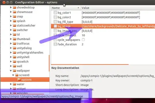

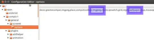

If you prefer not to risk ccsm then you can use gconf-editor (you can install it by running sudo apt-get install gconf-editor).
gconf-editor Install gconf-editor
Add the two plugins as shown.
Add a comma-separated list with the full-paths to your wallpaper as shown.

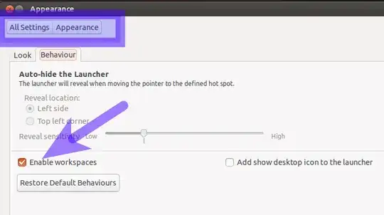

Finally - enable the use of workspaces in your System Settings (Cog Wheel menu option)
pic
Note: the 12.04 answer described using the gsettings editor as an alternative to ccsm. The equivalent for 14.04 is dconf-editor.

In next window, navigate to “apps/nautilus/appearances” and un-check “show_dekstop” in right. enter image description here

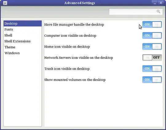

For those who don't have "show_desktop" in Configuration Editor-
  1. Install gnome-tweak-tool, enter in terminal-
    sudo apt-get install gnome-tweak-tool
  2. Key Alt+F2 and enter gnome-tweak-tool and hit enter.
  3. Click on ▸ Desktop ▸ Have file manager handle the desktop ▸ switch to Off
picture of gnome-tweak-tool dialog box
4.Proceed with the above instructions for changing compiz settings.

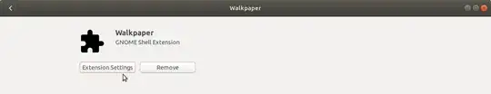

Install the Walkpaper GNOME Shell Extension from Ubuntu Software. Set a different wallpaper for each workspace by having the wallpaper switch on workspace change. After installing Walkpaper click the Extension Settings button in the Walkpaper screen in Ubuntu Software to open a Walkpaper window. In the Walkpaper window you can change the settings for each workspace by double-clicking on the current wallpaper and browsing to a new wallpaper image.
Walkpaper gives an error in GNOME Shell 3.30 on loading – global.screen is undefined. A simple user workaround is to run gedit ~/.local/share/gnome-shell/extensions/walkpaper*/extension.js and find and replace all occurrences of global.screen with global.workspace_manager. Restart gnome-shell with setsid gnome-shell --replace and press the Enter key before closing the terminal, and it should work.
