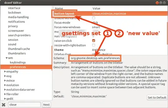

You can move buttons to the right with:
gsettings set org.gnome.desktop.wm.preferences button-layout ':close,minimize,maximize'
or, maybe better to twitch "close" button with "maximize" button:
gsettings set org.gnome.desktop.wm.preferences button-layout ':maximize,minimize, close'
And move them back to the left with:
gsettings set org.gnome.desktop.wm.preferences button-layout 'close,minimize,maximize:'
To get the current settings, use:
gsettings get org.gnome.desktop.wm.preferences button-layout
See man gsettings for more info, and, as a bonus:
dconf Editor
In this case the changes are made in ~/.config/dconf/user file which is expected to be in the binary dconf (GVDB) database format. Only programs like dconf Editor or gsettings can safely edit this file.
