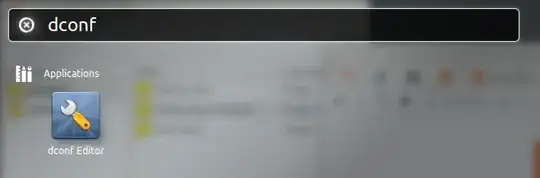

To edit DConf settings install the dconf-toolsInstall dconf-tools package and then open dconf Editor:

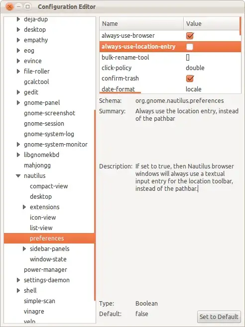

The key you are looking for is org ➜ gnome ➜ nautilus ➜ preferences ➜ always-use-location-entry. Make sure it is unchecked:

I set always-use-location-entry to false in dconf-editor and the location entry still persists. I got no bread crumb buttons.
The solution I found was that you have to set always-use-location-entry to false in BOTH gconf-editor AND dconf-editor.
If either one of these has always-use-location-entry set to true, it will fail.
For gconf-editor it is found under apps>nautilus>preferences
See Alvin Row's answer for how to change the setting in dconf-editor
dalek
I had to install dconf-tools and change setting 'always-use-location-entry' in org.gnome.nautilus.preferences to False via dconf-editor. Changing the same entry in apps.nautilus.preferences with gconf-editor didn't help.
