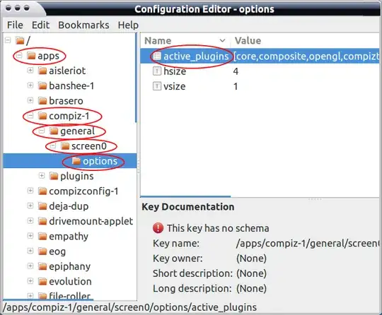

  • Run gconf-editor from Terminal or Alt+F2
  • Navigate to apps > compiz-1 > general > screen0 > options
  • Edit the key: active_plugins gconf Navigation Path

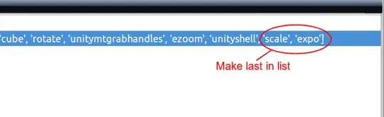

  • Move "Scale" to the bottom of the list.
  • Move "Expo" to bottom right above "Scale" and underneath Unityshell. active_plugins key
I say "semi-permanent" because some software updates (Unity) may cause the plug-in order to get rearranged, so you may need to repeat these steps 2 or 3 times per month.

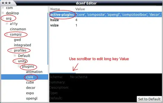

  • Run dconf-editor from Terminal or Alt+F2
  • Navigate to /org/compiz/profiles/unity/plugins/core
  • Edit the key: active-plugins dconf navigation path
  • Move 'scale' and 'expo' to last in the list. active-plugins key
Note that system updates may revert this fix and you may have to use dconf to fix it again.
