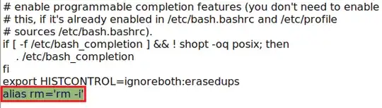

To create an alias permanently add the alias to your .bashrc file
gedit ~/.bashrc
And then add your alias at the bottom.
alt text
Now execute . ~/.bashrc in your terminal (there should be a space between the . and ~/.bashrc.
Now you can check your alias.
alt text
