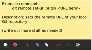

One thing you might consider is using a "sticky note" application like xpad. You could paste the commands there, along with a description of what each one does. When you want to run one, copy it from xpad with CTRL+c and paste it into your terminal with CTRL+SHIFT+v.
Here's what it could look like:
To install, do the following:
sudo apt install xpad
Then run it with:
xpad
