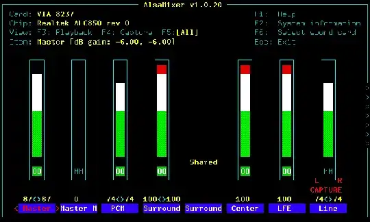

Type alsamixer:
This can be used to adjust both input and output volume levels.
