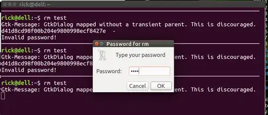

Sometimes it's not our friends, we are our own worst enemies
I've written a script to password protect rm like the OP requested but also put in edits to prevent you from accidentally deleting:

if [[ $(id -u) != 0 ]]; then # Only non-root processes enter password (ie "sudo rm ..." is ok)
  if [ $Terminal == "Y" ] ; then
  # Only running from a terminal needs password (ie not cron)
    # log rm usage to /var/log/syslog
    PARENT_COMMAND="$(ps -o comm= $PPID)"
    logger "$PARENT_COMMAND"" - rm command was used on file: ""$fullname"
    # Get password
    Password=$(zenity --password --title="Password for rm")
    encryptPassword=$(echo -n "$Password" | md5sum)
echo "md5sum: $encryptPassword" # Comment out after viewing one time and updating line below.
    if [[ "$encryptPassword" != "d2c30dc65e59558c852ea30b7338abbe  -" ]]; then
        echo "Invalid password!"
        exit 1
    fi
  fi # non-terminals can't enter password.
fi # root doesn't need to enter password.
# Call REAL rm command with parameters passed to this wrapper sript
/bin/rm "$@"
exit 0
Change the password "WE2U" to anything you like and save the file.
Mark new rm script as executable
Flag new rm script as executable using:
sudo chmod +x /usr/local/bin/rm
How it Works
rm password
Unless the password is WE2U, the first time you run the script you will get "invalid password" and the encryption key for the password you entered is displayed. Copy and paste this encryption key from the terminal into the script. Then comment out the line with the echo that displayed the encryption key on the terminal.
Because the path /usr/local/bin is higher on the list than /bin our command rm is called. After getting valid password it calls /bin/rm to do the real removal.
As Thomas Ward pointed out in another answer, if you were to do a sudo apt-get install ... you could be asked for password a thousand times. The script checks if sudo is used and doesn't ask for a password. Furthermore if rm is called from within GUI application no password is required.
The script calls logger to record every time rm was manually called using the terminal. Command usage is recorded to /var/log/syslog.

If you want to password-protect rm, a solution would be to make a wrapper for rm that would require root privileges, and ask for a password otherwise. (NOTE: This wrapper may go away when the coreutils package is updated or reinstalled.) Also, please note this only secures rm, there are still many, many other ways to delete a file.
Open up a terminal and become root. Then run sudo mv /bin/rm /bin/rmold to move the old rm to another place.
Now run sudo nano /bin/rm to create a wrapper.
In Nano, type the following:
#!/bin/bash
/bin/rmold "$@"
exit "$?"
Then hold CTRL, and press X to exit. Press Y when you're prompted, then hit ENTER to save the file.
Finally, we need to give this the appropriate permissions:
sudo chmod a+x /bin/rm
And there you go.
A very silly workaround for a very silly issue.
