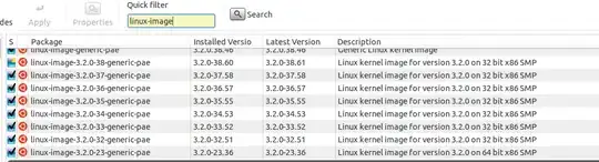

you can clear more space by clearing the old kernels which you can do it easily from the Synaptic package manager.
There remove the old kernels , not the current one. For better purpose stay with two old recent kernels and clear remaining all of them.That can give you more free space.
