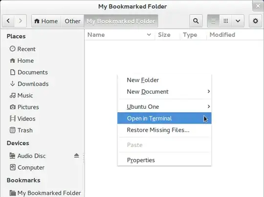

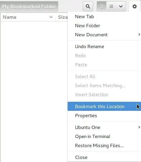

Even though there exists some command line way to do it faster, I would personnally recommand using a Nautilus extension called nautilus-open-terminal.
First install the package nautilus-open-terminal and bookmarks your favorite folders with Nautilus. On Nautilus 3.6.*, you'll have to go into the gear menu and select Bookmark this Location.
Then use Nautilus bookmarks to go faster in your favorite directories, and just right click on an empty space and select Open in Terminal.
Now you can have both command line and file manager quick access to your favorite directories.
