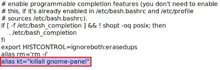

  • To add this alias permanently you have to add the above command into .bashrc file
    gedit ~/.bashrc
  • Add the first command at the end of your .bashrc file,
    alt text
  • To refresh your .bashrc file type the following in terminal,
    . ~/.bashrc or source .bashrc
  • Now you can type kt in terminal it will perform the action of killall gnome-panel

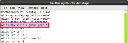

  • To list all your aliases type alias in terminal.
