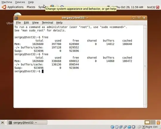

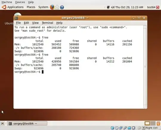

Here are screenshots of a (rather old) vanilla Ubuntu running in a VirtualBox with 1GiB RAM:
32 bit: uses 388 MiB of RAM right after booting, no additional applications running (from the screenshot, 397780KiB, which is 388MiB)

64 bit: uses 491 MiB of RAM (from the screenshot, 503452KiB = 491MiB)

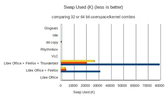

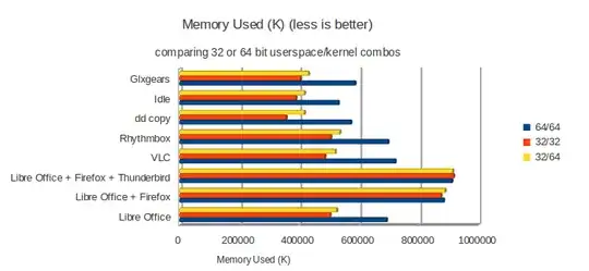

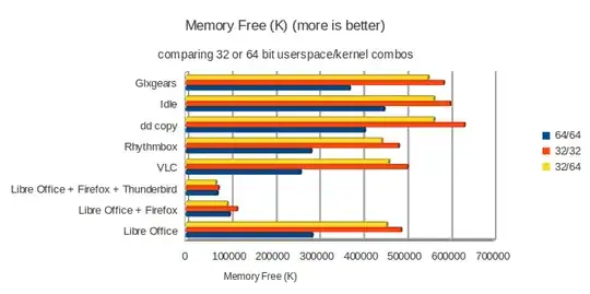

Additionally, in my testing, a web-application written in Python used up to 60% more memory on a 64-bit machine which resulted in a test suite running in 380 secs on a 32-bit machine but taking 523 seconds on a 64-bit one (both with 1GiB of RAM). If the machines were not RAM-limited the results would likely be different (as phoronix tests show).
Here are some more thorough and recent tests: http://kernel.ubuntu.com/~cking/x32/Quantal-x32-power-memory-comparisons.ods
mem free mem used swap used
Basically, it's like giving up 30% of your RAM in exchange of possible gain of 10% CPU speed.
