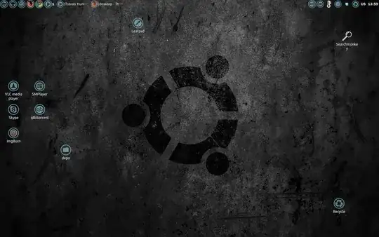

I think that the illustrative pictures that people see on the Internet for Xubuntu and Lubuntu desktops are misleadingly simplistic compared to Unity, and so people tend to chose the later no matter their specs. But to make the former ones look stylish is easy. Here is a Xubuntu desktop:
Screenshot #1

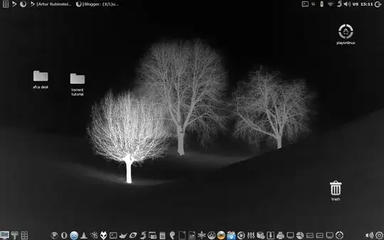

And Lubuntu/LXDE:
Screenshot #2
