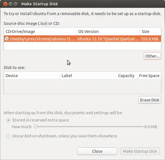

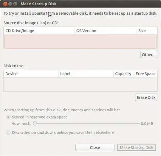

    • With the image already downloaded, Open DASH and type Disk Creator
    • Open Startup Disk Creator
    • Click on the Other Button to select the image you want to burn to your USB Device. Search and select the image you want
    • If you haven't already, connect the USB Device you wish to use as a LiveUSB installer

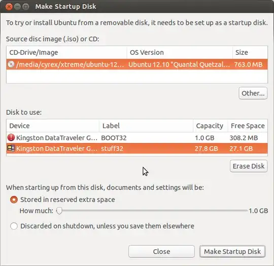

    • You can either delete the partition (Erase it) or use an empty one. In this case I have a partitioned USB Drive. Select any partition or USB Drive that has at least 1GB of space since the image is about 700MB / 800MB in size. After which click on Make Startup Disk.
    • The option Stored in Reserved Extra Space is for when you want to use the LiveUSB as a bootable OS which means you will connect to the Internet with it, will do Documents with it, download music, videos, etc.. They will all be stored in a space reserved for them. You can tell the Disk Creator how much space you want to reserve for this.

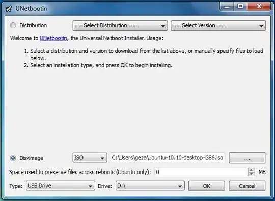

For a live USB use UNetbootin, it is a cross-platform application that allows you to create bootable USB sticks (without even formatting your Flashdrive)
