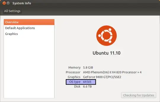

Ubuntu 12.04+ with Unity
  • Hit Command(mac) or Window key.
  • Type Details, and select "Details" icon
  • Read "OS type" field
  • 64 bit OS will read "64-bit"
Alternative to get the above screen:
  • click System Menu (gear at top right corner)
  • click "About this Computer"
I know the terminal responses are good but I guess this is the GUI answer. :)
Ubuntu 11.04 with Unity
  • Type System info, and select System Info icon

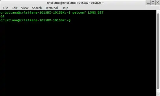

A very easy and short way is:
Open the Terminal, write the following and press Enter.
getconf LONG_BIT
The resulting number (in my case 64) is the answer.
terminal - getconf LONG_BIT
