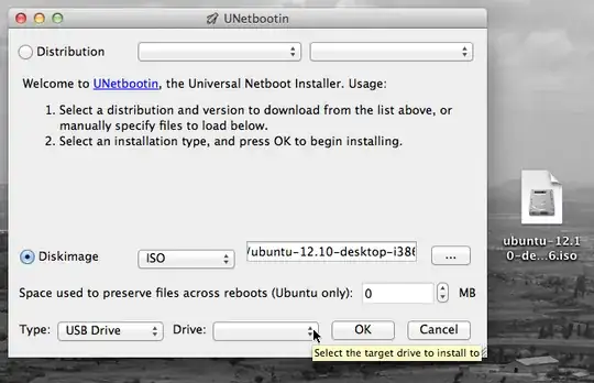

    So it makes sense for you to use UNetbootin for Mac OS X. Get it from there, then run it, open up the ISO image you downloaded (select Diskimage instead of Distribution in UNetbootin), and write it to the USB flash drive.
    UNetbootin on Mac OS X, about to write an Ubuntu ISO to a USB flash drive (the drive still needs to be selected)
    UNetbootin on Mac OS X, about to write an Ubuntu ISO to a USB drive (image contributed by Elisabeth Terrio)
    Be careful not to write it to the wrong drive, as if you do that, it will overwrite that drive's contents with an Ubuntu live system!
