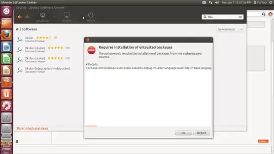

I have done which you said . But now I'm trying to install Okular but this is showing :-(
This should fix it: http://ubuntuforums.org/showpost.php?p=11593258&postcount=2.
