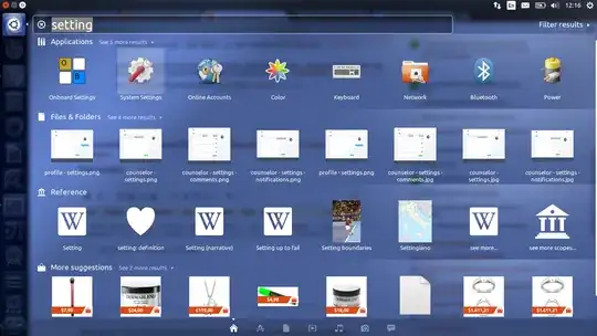

I have Ubuntu 14.04 LTS, and sometimes when I use this command, I encounter with this problem. For solving this you can use the following way:
  1. please go to system settings.
    system setttings

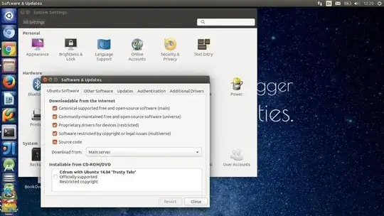

  2. click on software & updates
    software & updates
  3. go to other software section. You can find the links that are relative to this error. Uncheck the relative links and click close. If you can't find relative link you can go to ubuntu software section and uncheck options that may can relative to this error. Sometimes with changing Download Server to Main Server your problem can be solved. For changing download server you can go to ubuntu software section and change Download From and choose Main Server.

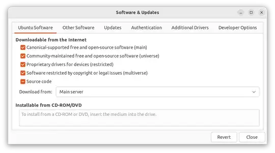

This worked for me:
  1. Open "Software & Updates" by launching that application or by running this in the command-line:
    software-properties-gtk
    Screenshot
  2. Make all four checkboxes are ticked (main, universe, restricted, multiverse), unless you don't want all four sources of software
  3. Change the server in control labelled "Download from:" to something else. For some reason, making a change forces APT to refresh the software database in a way that works.
  4. Close, and click "Reload" when prompted.
