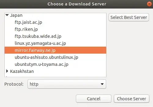

I solved it. I switched to a different mirror of a different country
Server i am currently using
