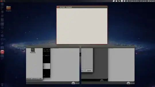

  • Update 5
    After I could install wine as suggested by Sneetsher. I still can't run .exe files using wine. Screenshot belowis for:
    wine ~/.wine/drive_c/windows/notepad.exe is top window. And both windows in the bottom are for OLLYDBG.EXE by clicking on it.
    I can't make any edit through notepad.
    $ wine --version
    wine-1.6.2
    $ which wine
    /usr/local/bin/wine
Please, let me know If I have to provide more information.

About the rendering issue, the windows are grayed. As it seems from wine --version 1.6 but we have installed 1.7 & which wine brought that system have a local version of wine installed from source.
Try echo $PATH, you have some thing like:
/usr/local/sbin:/usr/local/bin:/usr/sbin:/usr/bin:/sbin:/bin:/usr/games:/usr/local/games
See..the variable PATH, it is where the system looks for executable. So writing just wine in shell, it will look in /usr/local/sbin folder, if not found then /usr/local/bin then /usr/sbin then /usr/bin...
Quick fix, removing that local copy of wine:
sudo rm /usr/local/bin/wine*
If you want to keep it, you may run wine with full path:
/usr/bin/wine ...
