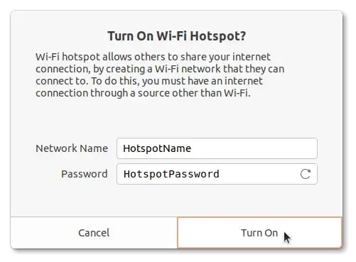

Ubuntu 20.04 LTS and newer

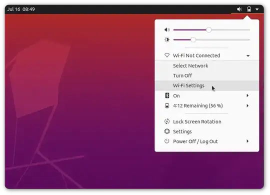

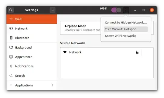

With GNOME 3.36 desktop on Ubuntu 20.04 LTS, WiFi tethering has become easier than ever! Just open the Wi-Fi Settings from system menu.
System Menu
In the Wi-Fi Settings window, click on the drop-down menu on top right and select Turn On Wi-Fi Hotspot option.
Turn On WiFi Hotspot
A dialog will show up, where you can set the name and password for your new hotspot.
Set name and password for hotspot

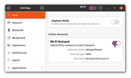

If your hotspot gets created successfully, Wi-Fi Settings would now show a section with a toggle for the newly created hotspot.
Newly created hotspot

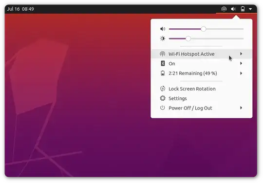

A hotspot indicator would appear on the top bar as well, showing it's active status.
Active hotspot indicator

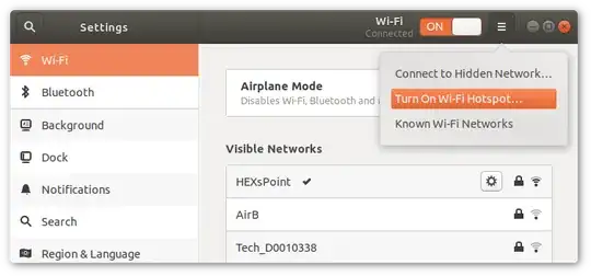

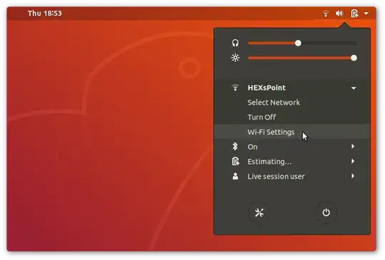

GNOME 3.28 desktop on Ubuntu 18.04 LTS makes it easy to start a WiFi hotspot. Open the Wi-Fi Settings from system menu.
GNOME system status menu
And then from the hamburger menu on Wi-Fi Settings, select Turn On Wi-Fi Hotspot. That's it, your WiFi access point is now up and running!
WiFi Settings

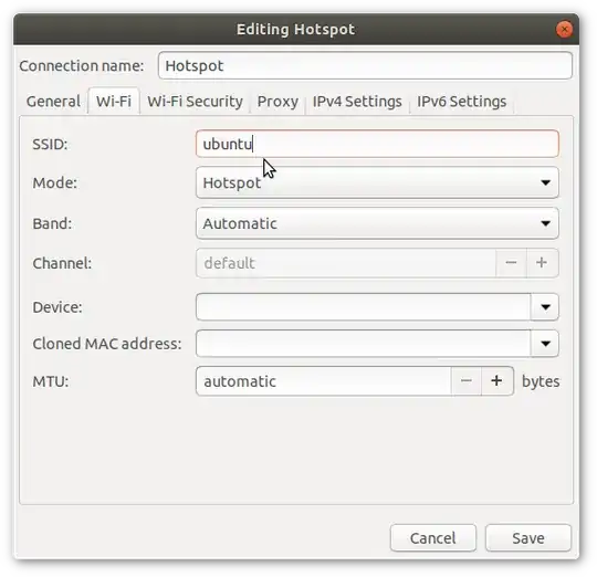

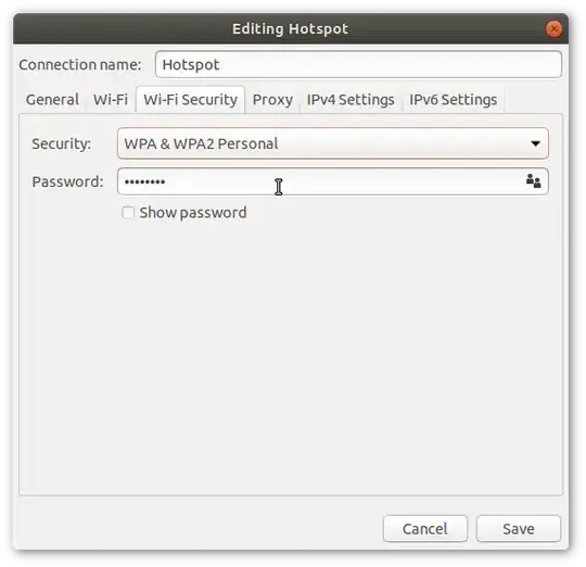

If you wanna change the name (SSID) and password of your access point, open Network Connections editor tool by entering the following in either Terminal or Alt+F2:
nm-connection-editor
Network Connections
Double click on Hotspot and the editor window'll appear. You may change SSID and password from the Wi-Fi and Wi-Fi Security tabs.
Edit SSID Edit password

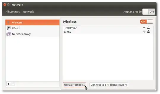

Network comes with a built-in option to start an Ad-Hoc hotspot. So, let's use this first, so that it could be configured and converted to an Access Point mode hotspot in the next step.
Search Network in Dash and open it.
DashSearch
Press the "Use as Hotspot" button and Network Manager will start an AdHoc hotspot.
Hotspot
But that's not what we want, is it? Stop the hotspot.

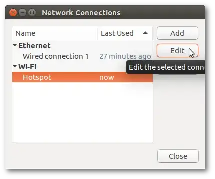

Step 3: Configure Hotspot

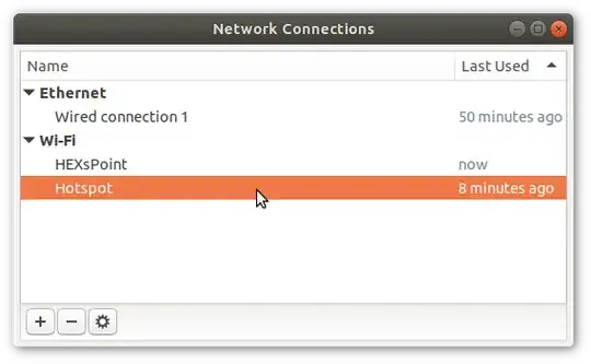

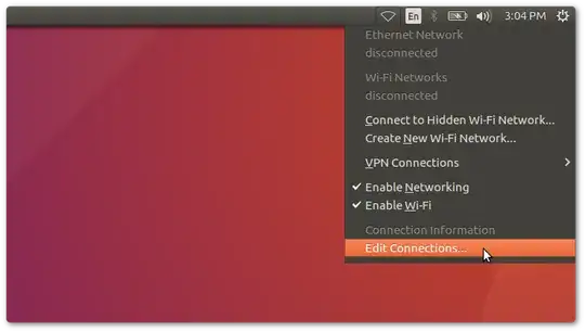

Open Network Connections from Dash or 'Edit Connections' from Network Indicator menu.
Edit Connections
In the Network Connections window that appears, there'll be a connection named Hotspot listed under the WiFi section. Select it and click the 'Edit' button.
Network Connections

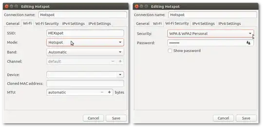

In the window that appears, you may edit the broadcast name (SSID) of your hotspot. Now comes the most important part of this configuration: change mode to 'Hotspot', which'll finally convert the hotspot to Access Point mode. Users of Ubuntu 14.04 LTS'll notice that this mode isn't available to choose from the dropdown. Don't get disappointed, as you can still do it via an extra Step 3.1.
Edit Hotspot Name and Password
Save and open the same Editing Hotspot window again. This time go to the WiFi Security tab for selecting password type. If you don't want to set a password, you can set security to none and thus create an open hotspot. If you're setting a password, it's recommended to change the security key from WEP to WPA2. Once the configurations are done, don't forget to save it so that the changes could apply.
In the General tab, make sure that “Automatically connect to this network when it is available” is turned off (unless you only ever use your wifi as a hotspot). Otherwise, since the hotspot is always available, you won't see the menu entries to connect to other wifi networks in the network manager applet.

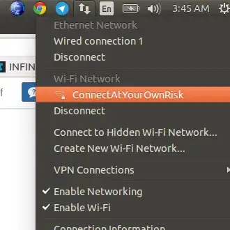

Step 4: Start Hotspot

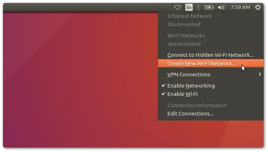

Now that the configuration part is over, we'll start the hotspot. Click on 'Create New Wi-Fi Network' from Network Indicator menu.
Create New WiFi Connection
In the window that appears, click on the connection drop-down button and change "New..." to "Hotspot". Press the "Create" button and your hotspot will start running. From now on, whenever you need a hotspot, you just need to do this step i.e Step 4 only.
Start Hotspot
K.. That's all folks! Have fun with your new Access Point

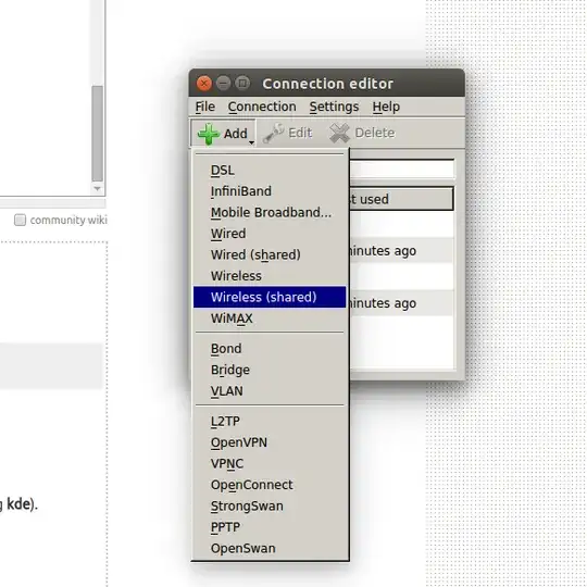

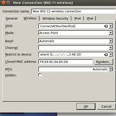

2.Now click + Add and select Wireless (shared)
Adding A new connection
3.Now, you'll see the below window.
Connection setup tab
SSID: Give a name for your new Hotspot
Mode: Select Access Point
Cloned MAC address: Click Random button to generate a random MAC address.
Everything else should be already set to fine.

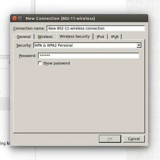

4.Now let's go to the Wireless Security tab.
WPA Password tab
Select WAP & WPA2 Personal and type your password.
Click Ok.
