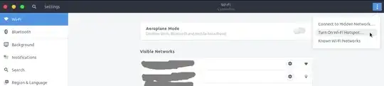

  1. Make sure your Wi-Fi is enabled (not disabled by hardware or toggle in the system menu at the top right).
  2. Click on Activities, search for Settings and open it.
  3. Go to Wi-Fi section.
  4. Click on the vertical ellipsis (three vertical dots) or something similar at the top right to open a pop-up dialogue. You should find a "Turn On Wi-Fi Hotspot" option there:
