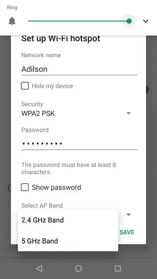

I had the same issue and fixed it by changing the WiFi hotspot setting on my device from 5GHz to 2.5GHz.
hotspot problem
