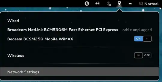

  • Click on the little network icon, at the top panel. enter image description here
  • Select "Network Settings"

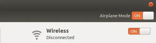

  • Select "Wireless" in the left pane. enter image description here
  • Click on the On/Off toogle on the right pane. enter image description here

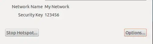

  • Click on "Use as hotspot", You don't need to specify name enter image description here
That's it. A wireless wifi-hotspot is created with autocreated name and security key. The network name and security key is displayed immediately. enter image description here
See the screenshots below.

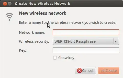

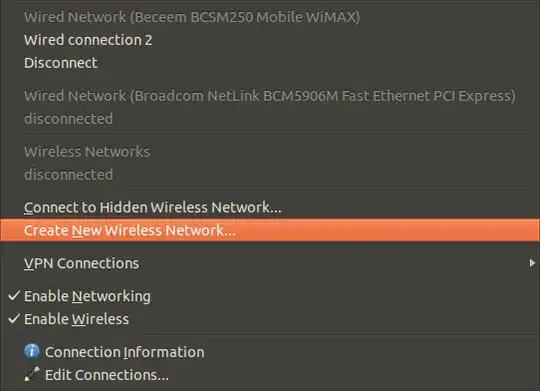

  • Click on the network activity icon, a menu will appear like the one below. enter image description here
  • Click on "Create new wireless network...", a window will appear like thisenter image description here

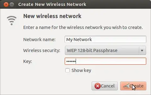

  • Type in your network name and security key. enter image description here
  • Click on create button.
A network will be created with the name typed.
