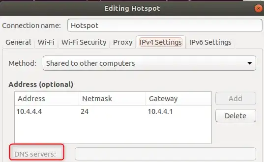

I thought that it should be possible to start a DNS server on my Ubuntu and configure the Hotspot to use it. But in the nm-connection-editor the DNS servers field is deactivated enter image description here
