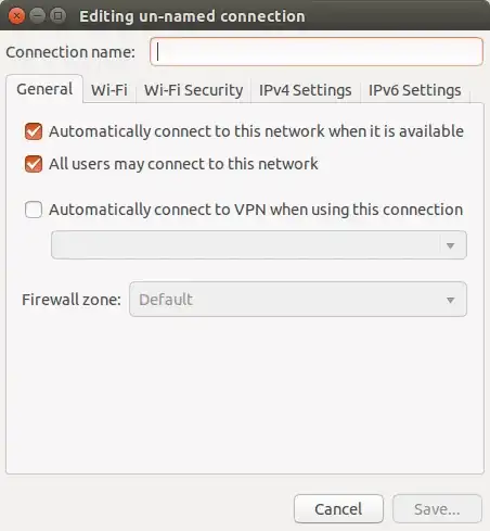

If you can't do that, try WiFi hotspot available to all users. See:
Note, All users may connect to this network box is checked. This means this network will be online before anyone logs on. So you don't need to log on to the desktop to make it work.

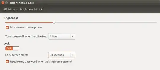

Second, set up lock screen so that the screen is locked if no one uses it.
See Lock is set to On. You can also manually lock the screen by pressing Ctrl+Alt+L before you leave the computer.
