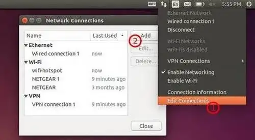

  2. Go to Network Icon on the top panel → Edit Connections, then click the Add button in the pop up windows.
    Edit connection

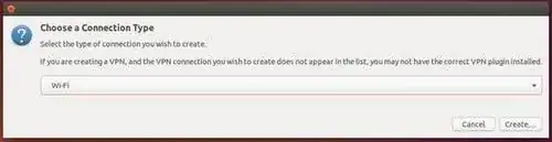

  3. Choose Wi-Fi from the drop-down menu when you're asked to choose a connection type:
    Choose wifi connection type to wifi

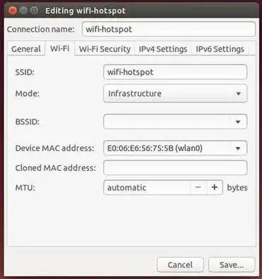

  4. In the next window, do:
    • Type in a connection name. The name will be used later.
    • Type in a SSID
    • Select mode: Infrastructure
    • Device MAC address: select your wireless card from drop-down menu.
    Create wifi hotspot

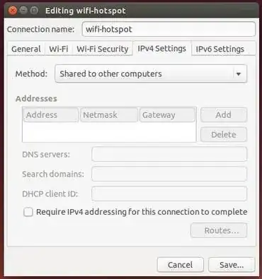

  6. Go to IPv4 Settings tab, from Method drop-down box select Shared to other computers.
    Wifi IPv4 shared to other computer
When done, click the save button.

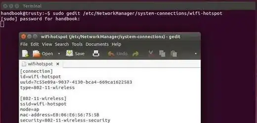

Now press Ctrl+Alt+T on keyboard to open terminal. When it opens, paste the commands below and hit Enter to edit the configuration file.
gksudo gedit /etc/NetworkManager/system-connections/wifi-hotspot
Replace wifi-hotspot with the connection name you types in step 4.
When the file opens, search for the line mode=infrastructure and change it to mode=ap.
Finally save the file.
Change mode to ap

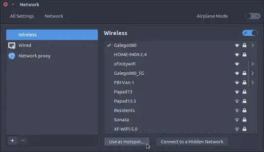

1. Open settings an click on network
Settings window of Ubuntu with mouse over "Network"
2. Click on Wirelss and make sure that you have it enabled!
Click on "Use as Hotspot..." remember to make sure you are connected to the internet via ethernet.

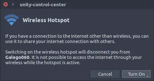

3. "Click Turn On"
This is what pops up for me since I am still connecting to the wifi, but it still works regardless.
Once you do that, you'll be greeted by the connection Name, and the autogenerated password key. Simply join that connection and type in the key and you're good to go!
