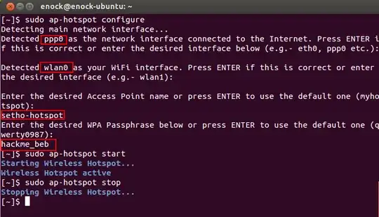

You need to create infrastructure (Access Point mode) wireless hot-spot rather Ad-hoc hot-spot. In linux(ubuntu) i used ap-hotspot and which works for me(i got connected WP8 and Android 4.4, dont know about iPhones).

Configuration
sudo ap-hotspot configure
Configure_Sample
It will asks for interfaces, Access point name(which can be anything you want to see as wifi_hotspot name), password(which is your wifi_hotspot security key).
Now, if you able to configure successfully and dont get any kind of Unsupported wifi errors(if you get that simply means, your wifi_card doesnt support infrastrucutre Access point wifi_hotspot, so can do nothing on it), then procceed.
So just now start your hotspot as
sudo ap-hotspot start
If you want to stop then
sudo ap-hotspot stop
If you wanna see all available commands
sudo ap-hotspot

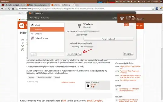

I have 2 wi-fi adapters installed for this. One native internal, and other via USB. I have to share with external USB because the internal one I am using to receive my conection. In your case you don't need another adapter, as you receive the conection via cable. Just follow my steps.
This is how I do. In System Settings...>Networks select the Wi-Fi adapter you want to uuse as a Hotspon, and click Use as Hotspot... button.
This will shortly activate the adapter to serve as a Hotspot. At the same window you have Options... function, and you can stop it in a same easy way.
Since ap-hotspot is deprecated, it's neither reliable or stable for newer Ubuntu distribution. The author of ap-hotspot recommended create_ap.
