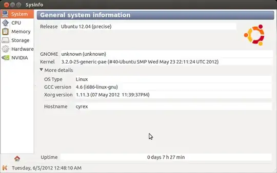

Install Sysinfo (sysinfo) from the default Ubuntu repositories. Sysinfo is a graphical tool that is able to display some hardware and software information about the computer it is run on.
It is able to recognize information about:
  • System (Linux distribution release, versions of GNOME, kernel, gcc and Xorg and hostname)
  • CPU (vendor identification, model name, frequency, level2 cache, bogomips, model numbers and flags)
  • Memory (total system RAM, free memory, swap space total and free, cached, active, inactive memory)
  • Storage (IDE interface, all IDE devices, SCSI devices)
  • Hardware (motherboard, graphic card, sound card, network devices)
  • NVIDIA graphic card: only with NVIDIA display driver installed
In Ubuntu 20.04 and later install System Profiler ( sudo apt install hardinfo ) instead of Sysinfo.
