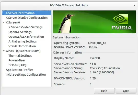

And installed nvidia-346 nvidia-settings. Running nvidia-settings shows me this:
Screenshot

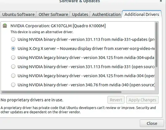

However, running sudo software-proprietry-gtk show me
Screenshot
NVidia-346 is not listed.
So am I still using the Nouveau drivers? If I pick any of the NVidia proprietry drivers from the list, rebooting will result in "System running in low graphics mode", "Could not detect display, graphics card etc." (How to fix "The system is running in low-graphics mode" error?).
How can I use the NVidia proprietry drivers?

The correct answer is: The xorg-edgers repackage the binary proprietary NVidia driver as "X.Org X-Server Nouveau". So that's why you see what you see in the "additional drivers" screen.
Now to see the exact version of the NVidia driver you're using you have to start nvidia-settings as you did or go to a terminal and execute nvidia-settings --version
This means that the next time the xorg-edgers repackage the newer driver, it'll get updated automatically, contrarily to installing the NVidia binary driver.
