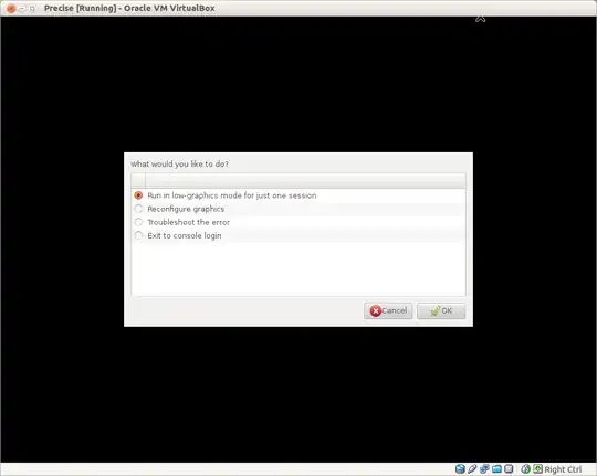

I faced a "The system is running in low-graphics mode error" like the on in this question How to fix "The system is running in low-graphics mode" error?
This happened in Virtualbox!
I'll go with the answer that the root file system ran out of space since I left the system downloading some stuff & previously I was notified that the system is low on space. Dumb of me but everyone makes mistakes. I was planning on moving the files to a shared folder later on.
The screen I get is similar to the screen in the link above. If I click on Ok, I get the following screen

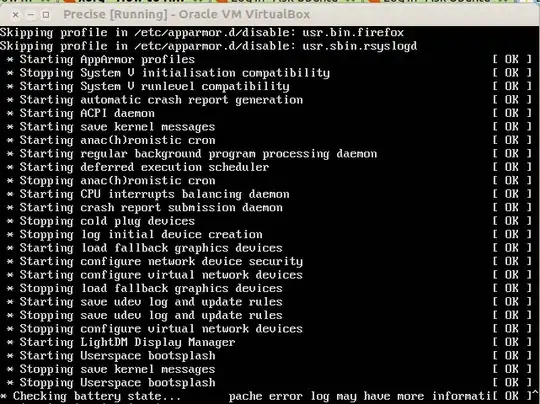

None of the options work. I even tried to use the shell mode to try to free some space but all I get is this screen
So my question is how can I get back to my system & move the files to the shared folder (which btw needs guest additions which is was already installed on the system!) or better (if easier) an USB?
